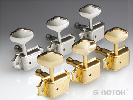

Gotoh indeed does make an open back vintge tuner .. SD700s .. mighty fine units for the bucks. the post and gearing are rock solid, no backlash, no play at all. Unfortunately, only butterbean style button, in all chrome, gold, x-gold and x-chrome I believe. Possibly cosmo black, like a gun metal chrome.

The Gotohs are very well made!
The Grovers have improved and the price is great!-BUT the finish on them is not so good!
If I had to just buy for value I'd take the Gotohs!

Gotoh open backs on more than a dozen instruments over the past several years. Absolutely NO PROBLEMS.
Short of Waverlies, they are all I would use in open back tuner situations.
